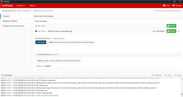

I have used Uniflash to program firmware into my device, as shown in the attached image.
The two firmware versions are located in the following directories:
C:\ti\mmwave_mcuplus_sdk_04_04_01_02\mmwave_dfp_02_02_04_00\rf_eval\rf_eval_firmware\

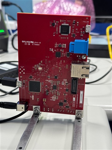

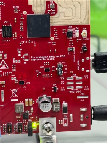

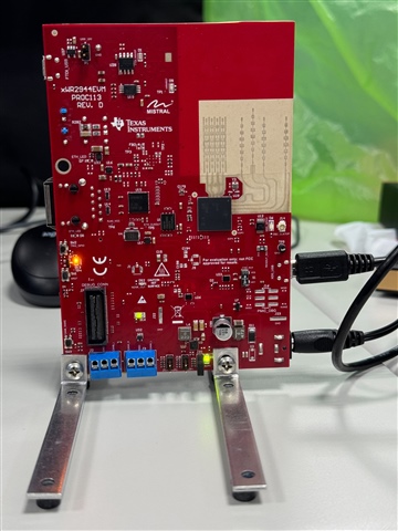

Additionally, I have included an image of my board setup for your reference.

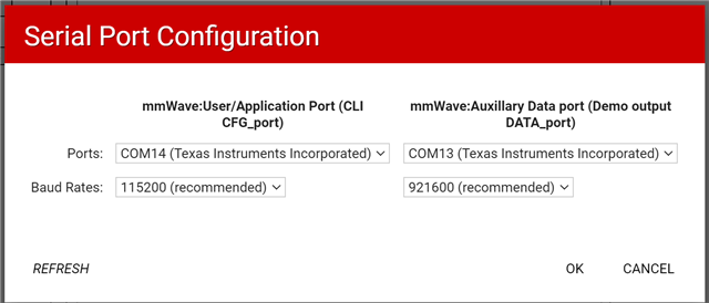

I am using the mmWave Demo Visualizer provided by TI, available at:
[https://dev.ti.com/gallery/view/mmwave/mmWave_Demo_Visualizer/ver/4.4.0/]
The connection process is depicted in the following image.
Despite following the steps, I am unable to establish a successful connection. Could you please advise if there is an issue with the firmware programming or any other potential problem?
  • Question 2: SBL Image Selection for Radar Toolbox Application
I successfully built the radar toolbox high-end corner application using CCS1220 and obtained the file awr2944_corner_radar.appimage. When using Uniflash, I am uncertain about which SBL Image file to select. Could you guide me on the appropriate choice for this process?

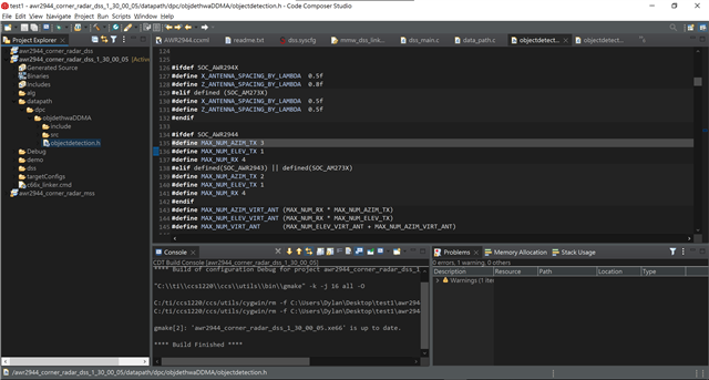

  • Question 3: Modifying TX and RX Quantities in Radar Toolbox
In the CCS1220, while building the radar toolbox high-end corner application, I wish to modify the number of TX and RX. Is this done by altering the parameters in the file shown in the attached image? Additionally, how can I verify the success of these modifications?

    The demo visualizer is only for the demo project or any RTB project with the modification of the demo.
    For the details on how to use the demo, please install the mmwave mcuplus SDK 4.4.1.2 and then read the user guide: C:\ti\mmwave_mcuplus_sdk_04_04_01_02\mmwave_mcuplus_sdk_04_04_01_02\docs\mmwave_mcuplus_sdk_user_guide.pdf
    What you are trying to flash is for the mmwave studio: C:\ti\mmwave_studio_03_01_01_00\docs\mmwave_studio_user_guide.pdf
    Then coming to your question for HECR rtb: High End Corner Radar Users Guide (ti.com), you can see that it has a different visualizer mentioned in the user guide as well.
    Please read through user guide of which project you wat to run and I would suggest you to follow it.

    Each application works with the specific visualizer eg. MMW Demo works on the browser-based visualizer and HECR works with the python-based visualizer provided in TI Rex.
    If you want to make it work on a different visualizer you need to understand the code and understand it completely (as in the first picture I see that you want to use the demo visualizer and run it with HECR)
    This is the user guide for the browser based visualizer which you can use for your development: AWR2944 mmWave Demo Visualizer User's Guide (Rev. A) (ti.com)

    In the uniflash you always need to flash both the SBL and the application image, when you do go through the mmwave MCU+ user guide as well, you can find the SBL in C:\ti\mmwave_mcuplus_sdk_04_04_01_02\mmwave_mcuplus_sdk_04_04_01_02\tools\awr294x\ sbl_qspi.release.tiimage
