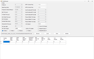

    I found that each chip hardcoded with 12 chirps and then three are active per chip. Deleting the hardcoded lines allowed for programming fewer than twelve. However, the metadata always indicates that 12 transmitters were active. I found that switching from 12 TX to less than 12 resulted in the table in the figure below to still contain 12 chirps. After power cycling, one chirp is correctly represented in the table. Therefore, I am confident that the software is working. The reduced size of the data indicates that the firmware is working, so the metadata must be hardcoded somewhere. Please advise on whether this can be fixed.
    Unfortunately the team that developed this SW is no longer available for support.
    Thank you
