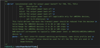

    That CLI configuration is being handled by the cli_mmwave.c : CLI_MMWaveProfileCfg function.
    and further same parameter is being passed to BSS via mmwavelink (rlSetProfileConfig API and rlProfileCfg_t struct)
    So with the CLI parameter change TX-power backoff should be applied to rf-front end.
    -> Valid Range for xWR294x devices: 0 to 20 in 1dB steps
    Best way to measure this change is to measure the Rf-Signal on TX antenna edge.
    with mmw demo, only 0 value had been tested, with that reason only I suggest to refer above statement to measure it on TX signal for confirmation.
    Jitendra

    Thank you for your support. We could resolve the issue and success to make back-off by changing cfg file because of your example code.
    We understand that  txOutPower in cgf file indicates only Tx1 value. Therefore is we want to decrease the total tx power with DDM, we must set the all channel of Tx1~Tx4 by setting 4* 8bit (interger) for each 4ch as shown below.
    Incorrect setting:  profileCfg 0 79.00 10 7 20.81 5 0 24 0 512 37500 0 0 36
    Correct setting:    profileCfg 0 79.00 10 7 20.81 84215045 0 24 0 512 37500 0 0 36
    ex: 5dB back-off
    5(10) = 101(2)
    00000101000001010000010100000101(2) => 84215045(10)
