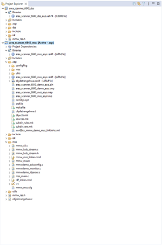

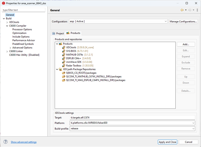

Trying to build ccs project area scanner with IWR6843AOP.  Using CCS12.5.  Please advise what I might be doring wrong.  I followed the user manual for area scanner.
Thanks.
-Adib

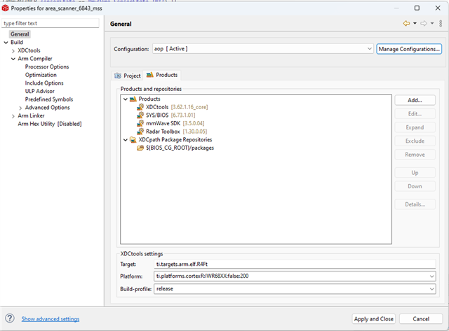

  • Hello.

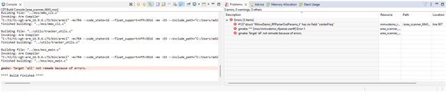

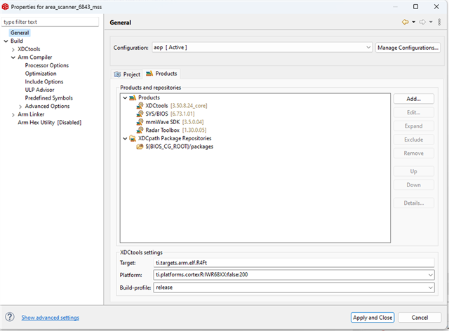

    Can you try using mmWave SDK 3.5.0.4 as suggested by the Area Scanner user guide?  That error usually occurs when using SDK 3.6 rather than SDK 3.5.0.4.
    Sincerely,
    Santosh

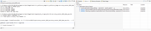

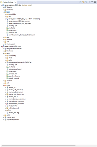

  • Thanks Santosh.  I did just do that.  And looks like the build worked and I could see the file for dss, but it looks like there is an issue still with mss (I do not see the binary).  See the screenshots.
    Let me describe what I want to be able to do and if I am taking all the right steps.  BTW.  I am working with IWR6843AOP.
    Steps.
    1.  Ran Out of Box Demo.
    2.  Ran Area Scanner Demo.
    3.  Trying to build Area Scanner so that I can modify and test parameter suggested by Pedrhom from TI.
    With the default image when someone stops they disappear.  I want to be able to detect the person as long as they are in the entire scene (i.e. Sleeping or resting).  My plan is to also test and combime aspects of the people counter and vital signs demo.  But would like to get familiar with working with TI CCS and code base using Area Scanner first.
    Any recommendations that will help speed up the ramping on this would be greatly appreciated.  Thanks again!

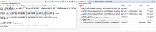

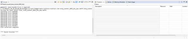

  • Here is the logs if it helps to see why the mss binaries were not generated.
    **** Clean-only build of configuration aop for project area_scanner_6843_mss ****
    "C:\\ti\\ccs1250\\ccs\\utils\\bin\\gmake" -k -j 4 clean -O
    DEL /F  "configPkg\linker.cmd" "configPkg\compiler.opt"  "area_scanner_6843_mss_aop.xer4f"
    DEL /F "objdetrangehwa.oer4f" "mss\mmw_cli.oer4f" "mss\mmw_lvds_stream.oer4f" "mss\mmwdemo_adcconfig.oer4f" "mss\mmwdemo_monitor.oer4f" "mss\mmwdemo_rfparser.oer4f" "mss\mss_main.oer4f" "utils\tracker_utils.oer4f"
    DEL /F "objdetrangehwa.d" "mss\mmw_cli.d" "mss\mmw_lvds_stream.d" "mss\mmwdemo_adcconfig.d" "mss\mmwdemo_monitor.d" "mss\mmwdemo_rfparser.d" "mss\mss_main.d" "utils\tracker_utils.d"
    RMDIR /S/Q  "configPkg\"
    Could Not Find C:\Users\adib-rs\workspace_v12\area_scanner_6843_mss\aop\objdetrangehwa.oer4f
    Could Not Find C:\Users\adib-rs\workspace_v12\area_scanner_6843_mss\aop\mss\mmw_cli.oer4f
    Could Not Find C:\Users\adib-rs\workspace_v12\area_scanner_6843_mss\aop\utils\tracker_utils.oer4f
    Could Not Find C:\Users\adib-rs\workspace_v12\area_scanner_6843_mss\aop\objdetrangehwa.d
    Could Not Find C:\Users\adib-rs\workspace_v12\area_scanner_6843_mss\aop\mss\mmw_cli.d
    Could Not Find C:\Users\adib-rs\workspace_v12\area_scanner_6843_mss\aop\utils\tracker_utils.d
    Finished clean
    **** Build Finished ****

    Finished building: "../mss/mmw_mss.cfg"
    Building file: "../mss/mmwdemo_adcconfig.c"
    Invoking: Arm Compiler
    "C:/ti/ti-cgt-arm_16.9.6.LTS/bin/armcl" -mv7R4 --code_state=16 --float_support=VFPv3D16 -me -O3 --include_path="C:/Users/adib-rs/workspace_v12/area_scanner_6843_mss" --include_path="C:/ti/mmwave_sdk_03_05_00_04/packages" --include_path="C:/ti/radar_toolbox_1_30_00_05" --include_path="C:/ti/ti-cgt-arm_16.9.6.LTS/include" --define=SOC_XWR68XX --define=SUBSYS_MSS --define=MMWAVE_L3RAM_NUM_BANK=6 --define=MMWAVE_SHMEM_TCMA_NUM_BANK=0 --define=MMWAVE_SHMEM_TCMB_NUM_BANK=0 --define=MMWAVE_SHMEM_BANK_SIZE=0x20000 --define=MMWAVE_L3_CODEMEM_SIZE=0x100 --define=DOWNLOAD_FROM_CCS --define=DebugP_ASSERT_ENABLED --define=_LITTLE_ENDIAN --define=OBJDET_NO_RANGE --define=GTRACK_3D --define=APP_RESOURCE_FILE='<'mmw_res.h'>' -g --diag_warning=225 --diag_wrap=off --display_error_number --gen_func_subsections=on --enum_type=int --abi=eabi --obj_extension=.oer4f --preproc_with_compile --preproc_dependency="mss/mmwdemo_adcconfig.d_raw" --obj_directory="mss" --cmd_file="configPkg/compiler.opt"  "../mss/mmwdemo_adcconfig.c"
    Finished building: "../mss/mmwdemo_adcconfig.c"
    Building file: "../mss/mmwdemo_monitor.c"
    "C:/ti/ti-cgt-arm_16.9.6.LTS/bin/armcl" -mv7R4 --code_state=16 --float_support=VFPv3D16 -me -O3 --include_path="C:/Users/adib-rs/workspace_v12/area_scanner_6843_mss" --include_path="C:/ti/mmwave_sdk_03_05_00_04/packages" --include_path="C:/ti/radar_toolbox_1_30_00_05" --include_path="C:/ti/ti-cgt-arm_16.9.6.LTS/include" --define=SOC_XWR68XX --define=SUBSYS_MSS --define=MMWAVE_L3RAM_NUM_BANK=6 --define=MMWAVE_SHMEM_TCMA_NUM_BANK=0 --define=MMWAVE_SHMEM_TCMB_NUM_BANK=0 --define=MMWAVE_SHMEM_BANK_SIZE=0x20000 --define=MMWAVE_L3_CODEMEM_SIZE=0x100 --define=DOWNLOAD_FROM_CCS --define=DebugP_ASSERT_ENABLED --define=_LITTLE_ENDIAN --define=OBJDET_NO_RANGE --define=GTRACK_3D --define=APP_RESOURCE_FILE='<'mmw_res.h'>' -g --diag_warning=225 --diag_wrap=off --display_error_number --gen_func_subsections=on --enum_type=int --abi=eabi --obj_extension=.oer4f --preproc_with_compile --preproc_dependency="mss/mmwdemo_monitor.d_raw" --obj_directory="mss" --cmd_file="configPkg/compiler.opt"  "../mss/mmwdemo_monitor.c"
    Finished building: "../mss/mmwdemo_monitor.c"
    Building file: "../mss/mmwdemo_rfparser.c"
    "C:/ti/ti-cgt-arm_16.9.6.LTS/bin/armcl" -mv7R4 --code_state=16 --float_support=VFPv3D16 -me -O3 --include_path="C:/Users/adib-rs/workspace_v12/area_scanner_6843_mss" --include_path="C:/ti/mmwave_sdk_03_05_00_04/packages" --include_path="C:/ti/radar_toolbox_1_30_00_05" --include_path="C:/ti/ti-cgt-arm_16.9.6.LTS/include" --define=SOC_XWR68XX --define=SUBSYS_MSS --define=MMWAVE_L3RAM_NUM_BANK=6 --define=MMWAVE_SHMEM_TCMA_NUM_BANK=0 --define=MMWAVE_SHMEM_TCMB_NUM_BANK=0 --define=MMWAVE_SHMEM_BANK_SIZE=0x20000 --define=MMWAVE_L3_CODEMEM_SIZE=0x100 --define=DOWNLOAD_FROM_CCS --define=DebugP_ASSERT_ENABLED --define=_LITTLE_ENDIAN --define=OBJDET_NO_RANGE --define=GTRACK_3D --define=APP_RESOURCE_FILE='<'mmw_res.h'>' -g --diag_warning=225 --diag_wrap=off --display_error_number --gen_func_subsections=on --enum_type=int --abi=eabi --obj_extension=.oer4f --preproc_with_compile --preproc_dependency="mss/mmwdemo_rfparser.d_raw" --obj_directory="mss" --cmd_file="configPkg/compiler.opt"  "../mss/mmwdemo_rfparser.c"
    >> Compilation failure
    mss/subdir_rules.mk:9: recipe for target 'mss/mmwdemo_rfparser.oer4f' failed
    "../mss/mmwdemo_rfparser.c", line 907: error #137: struct "MmwDemo_RFParserOutParams_t" has no field "centerFreq"
    1 error detected in the compilation of "../mss/mmwdemo_rfparser.c".
    gmake: *** [mss/mmwdemo_rfparser.oer4f] Error 1
    Building file: "../objdetrangehwa.c"
    "C:/ti/ti-cgt-arm_16.9.6.LTS/bin/armcl" -mv7R4 --code_state=16 --float_support=VFPv3D16 -me -O3 --include_path="C:/Users/adib-rs/workspace_v12/area_scanner_6843_mss" --include_path="C:/ti/mmwave_sdk_03_05_00_04/packages" --include_path="C:/ti/radar_toolbox_1_30_00_05" --include_path="C:/ti/ti-cgt-arm_16.9.6.LTS/include" --define=SOC_XWR68XX --define=SUBSYS_MSS --define=MMWAVE_L3RAM_NUM_BANK=6 --define=MMWAVE_SHMEM_TCMA_NUM_BANK=0 --define=MMWAVE_SHMEM_TCMB_NUM_BANK=0 --define=MMWAVE_SHMEM_BANK_SIZE=0x20000 --define=MMWAVE_L3_CODEMEM_SIZE=0x100 --define=DOWNLOAD_FROM_CCS --define=DebugP_ASSERT_ENABLED --define=_LITTLE_ENDIAN --define=OBJDET_NO_RANGE --define=GTRACK_3D --define=APP_RESOURCE_FILE='<'mmw_res.h'>' -g --diag_warning=225 --diag_wrap=off --display_error_number --gen_func_subsections=on --enum_type=int --abi=eabi --obj_extension=.oer4f --preproc_with_compile --preproc_dependency="objdetrangehwa.d_raw" --cmd_file="configPkg/compiler.opt"  "../objdetrangehwa.c"
    Finished building: "../objdetrangehwa.c"
    Building file: "../mss/mmw_lvds_stream.c"
    "C:/ti/ti-cgt-arm_16.9.6.LTS/bin/armcl" -mv7R4 --code_state=16 --float_support=VFPv3D16 -me -O3 --include_path="C:/Users/adib-rs/workspace_v12/area_scanner_6843_mss" --include_path="C:/ti/mmwave_sdk_03_05_00_04/packages" --include_path="C:/ti/radar_toolbox_1_30_00_05" --include_path="C:/ti/ti-cgt-arm_16.9.6.LTS/include" --define=SOC_XWR68XX --define=SUBSYS_MSS --define=MMWAVE_L3RAM_NUM_BANK=6 --define=MMWAVE_SHMEM_TCMA_NUM_BANK=0 --define=MMWAVE_SHMEM_TCMB_NUM_BANK=0 --define=MMWAVE_SHMEM_BANK_SIZE=0x20000 --define=MMWAVE_L3_CODEMEM_SIZE=0x100 --define=DOWNLOAD_FROM_CCS --define=DebugP_ASSERT_ENABLED --define=_LITTLE_ENDIAN --define=OBJDET_NO_RANGE --define=GTRACK_3D --define=APP_RESOURCE_FILE='<'mmw_res.h'>' -g --diag_warning=225 --diag_wrap=off --display_error_number --gen_func_subsections=on --enum_type=int --abi=eabi --obj_extension=.oer4f --preproc_with_compile --preproc_dependency="mss/mmw_lvds_stream.d_raw" --obj_directory="mss" --cmd_file="configPkg/compiler.opt"  "../mss/mmw_lvds_stream.c"
    Finished building: "../mss/mmw_lvds_stream.c"
    Building file: "../mss/mmw_cli.c"
    "C:/ti/ti-cgt-arm_16.9.6.LTS/bin/armcl" -mv7R4 --code_state=16 --float_support=VFPv3D16 -me -O3 --include_path="C:/Users/adib-rs/workspace_v12/area_scanner_6843_mss" --include_path="C:/ti/mmwave_sdk_03_05_00_04/packages" --include_path="C:/ti/radar_toolbox_1_30_00_05" --include_path="C:/ti/ti-cgt-arm_16.9.6.LTS/include" --define=SOC_XWR68XX --define=SUBSYS_MSS --define=MMWAVE_L3RAM_NUM_BANK=6 --define=MMWAVE_SHMEM_TCMA_NUM_BANK=0 --define=MMWAVE_SHMEM_TCMB_NUM_BANK=0 --define=MMWAVE_SHMEM_BANK_SIZE=0x20000 --define=MMWAVE_L3_CODEMEM_SIZE=0x100 --define=DOWNLOAD_FROM_CCS --define=DebugP_ASSERT_ENABLED --define=_LITTLE_ENDIAN --define=OBJDET_NO_RANGE --define=GTRACK_3D --define=APP_RESOURCE_FILE='<'mmw_res.h'>' -g --diag_warning=225 --diag_wrap=off --display_error_number --gen_func_subsections=on --enum_type=int --abi=eabi --obj_extension=.oer4f --preproc_with_compile --preproc_dependency="mss/mmw_cli.d_raw" --obj_directory="mss" --cmd_file="configPkg/compiler.opt"  "../mss/mmw_cli.c"
    Finished building: "../mss/mmw_cli.c"
    Building file: "../utils/tracker_utils.c"
    "C:/ti/ti-cgt-arm_16.9.6.LTS/bin/armcl" -mv7R4 --code_state=16 --float_support=VFPv3D16 -me -O3 --include_path="C:/Users/adib-rs/workspace_v12/area_scanner_6843_mss" --include_path="C:/ti/mmwave_sdk_03_05_00_04/packages" --include_path="C:/ti/radar_toolbox_1_30_00_05" --include_path="C:/ti/ti-cgt-arm_16.9.6.LTS/include" --define=SOC_XWR68XX --define=SUBSYS_MSS --define=MMWAVE_L3RAM_NUM_BANK=6 --define=MMWAVE_SHMEM_TCMA_NUM_BANK=0 --define=MMWAVE_SHMEM_TCMB_NUM_BANK=0 --define=MMWAVE_SHMEM_BANK_SIZE=0x20000 --define=MMWAVE_L3_CODEMEM_SIZE=0x100 --define=DOWNLOAD_FROM_CCS --define=DebugP_ASSERT_ENABLED --define=_LITTLE_ENDIAN --define=OBJDET_NO_RANGE --define=GTRACK_3D --define=APP_RESOURCE_FILE='<'mmw_res.h'>' -g --diag_warning=225 --diag_wrap=off --display_error_number --gen_func_subsections=on --enum_type=int --abi=eabi --obj_extension=.oer4f --preproc_with_compile --preproc_dependency="utils/tracker_utils.d_raw" --obj_directory="utils" --cmd_file="configPkg/compiler.opt"  "../utils/tracker_utils.c"
    Finished building: "../utils/tracker_utils.c"
    Building file: "../mss/mss_main.c"
    "C:/ti/ti-cgt-arm_16.9.6.LTS/bin/armcl" -mv7R4 --code_state=16 --float_support=VFPv3D16 -me -O3 --include_path="C:/Users/adib-rs/workspace_v12/area_scanner_6843_mss" --include_path="C:/ti/mmwave_sdk_03_05_00_04/packages" --include_path="C:/ti/radar_toolbox_1_30_00_05" --include_path="C:/ti/ti-cgt-arm_16.9.6.LTS/include" --define=SOC_XWR68XX --define=SUBSYS_MSS --define=MMWAVE_L3RAM_NUM_BANK=6 --define=MMWAVE_SHMEM_TCMA_NUM_BANK=0 --define=MMWAVE_SHMEM_TCMB_NUM_BANK=0 --define=MMWAVE_SHMEM_BANK_SIZE=0x20000 --define=MMWAVE_L3_CODEMEM_SIZE=0x100 --define=DOWNLOAD_FROM_CCS --define=DebugP_ASSERT_ENABLED --define=_LITTLE_ENDIAN --define=OBJDET_NO_RANGE --define=GTRACK_3D --define=APP_RESOURCE_FILE='<'mmw_res.h'>' -g --diag_warning=225 --diag_wrap=off --display_error_number --gen_func_subsections=on --enum_type=int --abi=eabi --obj_extension=.oer4f --preproc_with_compile --preproc_dependency="mss/mss_main.d_raw" --obj_directory="mss" --cmd_file="configPkg/compiler.opt"  "../mss/mss_main.c"
    Finished building: "../mss/mss_main.c"
    gmake: Target 'all' not remade because of errors.
  • Hello.
    Just to confirm, did you switch the SDK to 3.5.0.4 for the mss project as well?
    Sincerely,
    Santosh
  • Hi Santosh.
    Looks like it.  See these screenshots.
  • Hello.
    I recreated your setup(however both images were built), and the only difference is in the XDCtools version.  If you reinstall SDK 3.5.0.4, it should download all the proper tools and the appropriate version.  It should also prompt a warning when importing the project if the tool version is wrong, so make sure you have XDCtools 3.50.8.24 installed and try building both images again.
    Sincerely,
    Santosh
  • Hi Santosh.
    I reinstalled and mapped the XDCtools.  I am still not getting the build to work for mss.  Please see all updated screenshots.  Please advise.
    Thanks. -Adib
  • Hello.
    Have you made any changes to your demo?  It looks like you are trying to access the centerFreq field from that struct, but when I checked the demo, that struct doesn't have a field for centerFreq.  Please double check your code and make sure to add that field in that struct if you want it or replace it with an alternate field for your application.
    Sincerely,
    Santosh
  • Hi Santosh.
    I have not made any changes in the code.  Maybe when I imported I pulled in the wrong code?  How can I remove the full project and the import a new project as a clean project.  It should be pulling everything from the reference sdk and toolbox etc.  Suggestions?
    Thanks.
    -Adib
  • Hi Santosh,
    I was able to blow away the original workspace and created a new one and imported from the radar toolbox and now it all builds fine.  Thanks so much for all your help.  For follow up:
