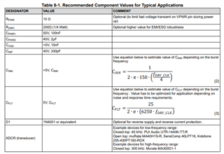

  • Hi Nick,
    First, do you have the correct values on CINN and CFLT?  The calculation is based on the frequency of the transducer and can be found below.
  • Hi Eddie,
    Thanks for the information.
    We are using a 14nf & 2.2nf respectively and a bandpass set to 0x25.  Using 4 or 8 pulses makes no difference.

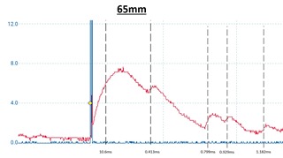

  • Hi Eddie,
    Thanks for the previous help which solved our issue.
    We are getting echo's back now (see screenshot) and wanted to ask if you have any algorithms to help determine the signals embedded in the echo while the transducer is still ringing within the first ms?
    Thanks again.
    Nick
  • Nick,
    Glad to see you are getting echos now.  We do not have an algorithm for detecting the signal during the ringing period.  If you are using a single transducer, you can try adding a resistor of 25 ohms to 500 ohms across the transducer to dampen the signal faster.  A decade box is useful for testing this.  Reducing the number of pulses used can also help with ringdown.  Section 6 of the app note below discusses this with a few examples.
    https://www.ti.com/lit/an/slda058/slda058.pdf
    If you are not able to acheive the minimum distance with these methods, I would suggest using a bistatic transducer configuration.
