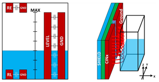

    Perhaps the plates are inadequately large for the distance from the liquid container and the design did not have sufficient margin, so many but not all pass.  I would suggest putting the pcb flush with the container for the failing unit and see if it still fails the test.  Another thing you could do is provide the capacitance readings.  It would help to have reference readings from one good unit and then readings from the faulty unit.  I would then need to have some explanation on the threshold chosen for the different states.
    Based on the layout Im seeing, it looks like you are doing something like this:
    whereas some of the examples we have for liquid sensing look like this:
    Can you comment on the algorithm the software is using for determining container states?
    Also could you provide scope shots of the CINx pins?
