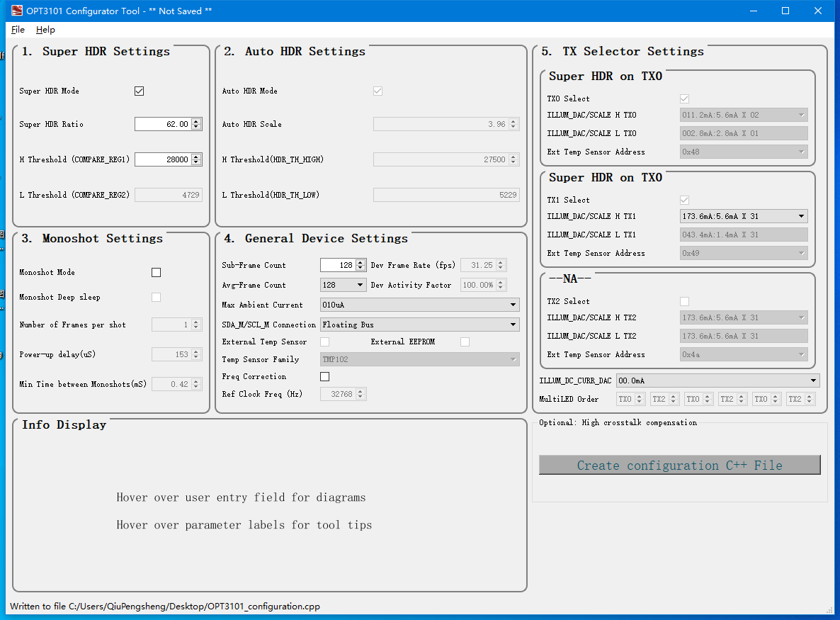

Use the OPT3101 Configurator Tool to configure the .CPP file in the SDK to Super-HDR mode as shown in figure below:

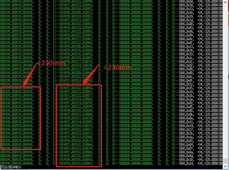

Open the INLAB_step_1 condition in the SDK to compile and download. When performing a 10mm, 20mm, 80mm, 120mm calibration with a white background, distance measurements beyond 230mm after calibration are abnormal and with a black background, distance measurements less than 80mm after calibration are abnormal.
The customer would like to know what background board should be used for calibration of INLAB_step_1 to ensure consistency? Could you help check this case? Thanks.
