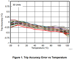

May I ask about the accuracy of step response?
The temperature step response is shown in Figure 3 and 4 of the datasheet, but how much variation is there between ICs?
p/n:TMP303DDRLR
Best Regards

Hi Shingu,
Variation of 30 IC is is shown in Figure 1. Variation is covered by Trip Point Accuracy specification in the 7.5 EC table.
thanks,
ren
