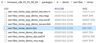

As the title question presented, I met some problems. rencently, I am studying demos supported by awr1843boost, I want to import the oob demo and run it.
thanks!

    I have installed mmwaveSDK_03_05_00_04 but not sdk_03_06_00_00,
    my question is what mode the file of xwr18xx_mmw_demo.bin, I mean what function this demo is when the file bin had been downloaded to awr1843 EVM and run. Because I met some problems that I want figure out MRR mode and SRR mode although I know the oob demo is a different demo to MRR demo or SRR demo. Thank you!
  • Hi
    You are correct, the oob demo does not support the SRR or MRR mode. It supports only the USRR mode which corresponds to TDM MIMO.
    Thank you
    Cesar
