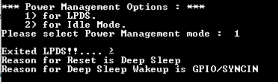

    I tried the power mode example in sdk5.3.0.2 on both IWRL6432 and IWRL1432, both show same result as below although i pressed the USER_SW(S3) with S1.6 OFF.  I read the power mode source code, cannot understand how it enter LPDS mode. In motion detection demo the Power_idleFunc is called to enter LPDS, but in power mode example i don't find any such call. Also based on my test it always stuck at below print. Pls help check.
    Reason for Reset is STC_PORZ
    *** Power Management Options : ***
    1) for LPDS.
    2) for Idle Mode.
    Please select Power Management mode : 1
    Entering LPDS....

  • Hi Andy,
    1. I have tested this myself with the prebuilt appimage of the power modes example in SDK 5.3.0.2 and it is working for me. Can you let me know which revision your EVM board is? Rev. A or Rev B? I have this working with Rev. B board and the following switch settings:
    S1.1-S1.6: {ON, OFF, ON, OFF, ON, OFF}
    S4.1-S4.4: {OFF, ON, ON, ON}
    S5.1-S5.2: {ON, ON}
    The correct output after pressing S3 is shown below.
