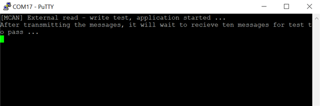

I'm testing the CAN-FD of 1432 and run mcan_external_read_write.release.appimage on boost evm. But there is no output.
The UART output is above, it seems this app can't be finished. Please help find the reason.

Hey Shawn,
I would recommend debugging the device and placing a breakpoint at the start of the App_mcanIntrISR
function to verify whether the MCAN ISR is being called. This would normally assert the semaphores for sending and receiving CAN data such as gMcanTxDoneSem. A similar issue with this example has been reported in another thread, but there was never a resolution reached.
Please let me know what you observe on your end, so that we can work towards resolving this issue.
