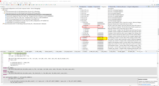

When running AWR6843 application in CCS debug mode, as below capture, RTI counter are still running when in suspend mode (pause or break point).
From TRM, "COS" bit of RTIGCTRL register can control the behavior as below description.
   * COS (0) - Counters are stop while in halting debug mode
   * COS (1) - Counters are running while in halting debug mode
However, with COS bit "0", RTI counters are still running.
So, is there something more to make it stop at the debug suspend mode (pause or break point...)?
