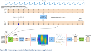

    I am working on the MMW demo in SDK 5.3, using BPM mode.
    The path is: C:\ti\MMWAVE_L_SDK_05_03_00_02\examples\mmw_demo\mmwave_demo
    In aoa2dproc.c, I didn't find the code about doppler compensation, could you please point out where doppler compensation is implemented? I may need to modify this code.
Thank you.

  • Sorry for the delay
    Please see
    C:\ti\MMWAVE_L_SDK_05_03_00_02\source\datapath\dpu\aoa2dproc\v0\aoa2dproc.c
    Code after "Line 1508  aoa2dProc_findRangeGates"
    Please see Figure 21
    C:\ti\MMWAVE_L_SDK_05_03_00_02\docs\MmwaveDemo_documentation.pdf

  • Hi Cesar,
      I carefully checked the code and documentation but didn't find anything about Doppler compensation, which should be between the 2D FFT and the 3D FFT, that is, between the two functions aoa2dProc_ConfigAndTriggerHwaDopplerComputation(obj); and aoa2dProc_ConfigAndTriggerHwaAngleComp(obj);
      The following is what I found in the documentation and code of xwr16xx. What I am looking for is code similar to the function MmwDemo_addDopplerCompensation(). Could you please help me point out the location of the code?
    Thanks!
    Yes, the doppler compensation algorithm implemented for AWRL1432 demo has been updated. It is no longer the same as for 16xx/18xx demo.
    Unfortunately, currently this is the only documentation we have available.

    Here is some additional information
    "We just mentioned in the document that this is viewed as DDM (Doppler division multiplex) MIMO modulation scheme (although with only one sentence and even not explaining the acronym), so there is no Doppler compensation per se in the scheme. The received signal is superposition of the two reflections, coming from two transmitted antennas. One Tx antenna has a constant initial phase, the other has phase rotated by 180 degrees every chirp. The reflections from single target are separated in doppler spectrum by pi. For example a single stationary objects will have two peaks in the Doppler spectrum (N-point FFT where N is number of chirps in the frame): one at zero position (due to Tx antenna that does not have phase rotation) and other at p position (due to Tx antennas with phase rotation by 180 degrees). If the object is moving, these two peaks will be both shifted left or right by the same amount according the to the object radial velocity. So we just take the three symbols (of three Rx channels) from the first peak position, corresponding to the first 3 virtual antennas, and there symbols from the second peak position, corresponding to the other 3 virtual antennas, and perform the mapping for further processing (no need for Doppler compensation). Of course, the maximum unambiguous doppler frequency is from -N/4+1 to +N/4-1, assuming signed indices, or (0 to N4/1) for positive Doppler and (3N/4+1 to N-1) for negative doppler.
    Also note that the detection is performed on the range/doppler heat map where the Doppler FFT is performed per virtual antenna, where the doppler FFT size is N’ = N/2, and the detected indices are from (0 to N’-1) unsigned, or  (-N’/2 to to N’/2-1) signed."
