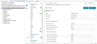

  • I changed the flash by referring to <<Flash Variants Supported by the mmWave Sensor>> , selected MX25V1635F flash, I read the datasheet of the flash, changed settings as shown in the red box below:
    When load images by uniflash:
    And then I changed the Quad Enable Type from 0 to 6, and it's still the same thing
  • Charles -
    I don't think you can mix and match SPI flash hardware and UniFlash selections like that. I would suggest use the SBL UART Flashwriter as recommended.

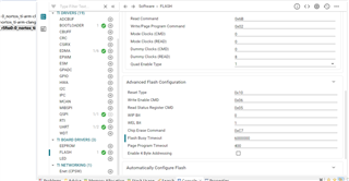

  • I referred to the documentation you mentioned and changed some configuration, but it still doesn't work.
    This is my setup:
    after flash that, print out these:
