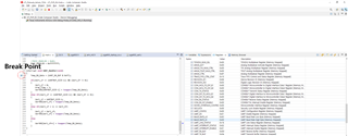

Temp_RX_Data = (UART_RX_BUF & 0xFF); inside interrupt void UART_Handler(void) function; Even if you set a breakpoint in this section, the function will not be entered.

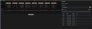

When measured with a scope, data is being transmitted normally from the PGA900 through the Tx pin, and is also being received normally from the PC's serial software.
When the "A\r" command is sent from the serial software, it should be received normally by the PGA900 board and entered as an interrupt, but it does not enter.

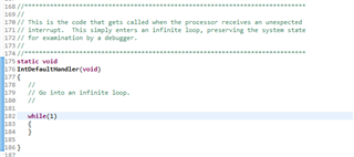

Instead, it enters the static void IntDefaultHandler(void) function in the PGA900_startup_ccs.c file and cannot exit the infinite loop.
Please check if there is any code that needs to be modified.

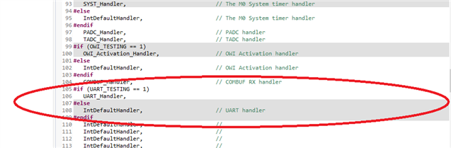

    All of that said, if your routine is working up until you TX to the UART, then most likely the issue is related to startup_ccs.c.  For the example program, the code is looking for UART_TESTING == 1 to set the call name to the interrupt routine otherwise it will go to the  IntDefaultHandler() instead.  As you have revamped the code to some degree, if you are using the original startup file but removed the configuration settings file, then you will be using the default handler instead of the desired handler.
