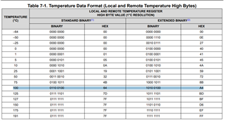

i have some questions about setting temperature limit function by configurating related registers, such as "Local temperature high limit", "Local temperature low limit ", "Remote temperature high limit (high byte)", "Remote temperature low limit (high byte) ", "Remote temperature high limit (low byte) " and "Remote temperature low limit (low byte) ".
Q1: i saw "7.3.1 Temperature Measurement Data" in datasheet. this is a rule of "measurement" temperature data from registers. when we configurate temperature limit function register, do i need to use the same rule?
for example, I want to set 100℃ as "Local temperature low limit ",do i need to configurate "Local temperature low limit " as 0110_0100b?
Q2.if Configuration Register [RANGE] is 1, in this situation, whether i need to write 1010_0100b in "Local temperature low limit "  if i want to set 100℃ as "Local temperature low limit "?
