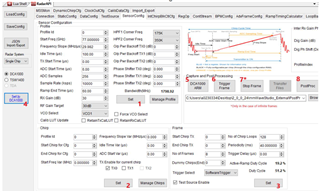

I am now using my AWR2243boost and DCA1000evm successfully, and I've recorded some data in mmWave studio.
However I'm struggling to review the data after the measurement is over because I cannot open the postprocessing window without the board/datacard being connected.
When I click the PostProc button on mmwave studio   (i.e. button number 8 here)

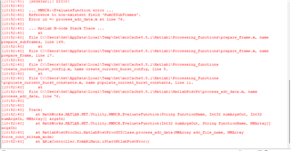

and this is what I get in the output:
this problem only occurs if the radar/datacard are not plugged in and connected
any ideas?
