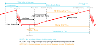

In the figure below, what are the recommended values for ADC valid strat time and excess ramping time before and after ADC sampling time?
Hiroyuki Taguchi
Hiroyuki Taguchi
Please see this Appnote
https://www.ti.com/lit/an/swra553a/swra553a.pdf
Please review the Timing Calculator (Section 5.4)
