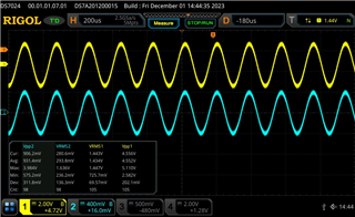

Currently I am using the PGA970 evaluation board connected to a 4-wire RVDT.
When I am reading out the phase angle via the GUI the phase angle seems to be jumping from 0-90 when the RVDT is fixed in a single position.
The excitation and return signals appear normal.

    I went back and collected a few data points using the GUI and the Low Level Configuration screen.  I used the read_all function and then transfered the data into a spreadsheet to calculate the phase angle.
    As you can see for the 3 data points I have collected the phase angle changes from ~180-~54 degrees.  The waveforms on the scope still look nearly identical as before.

  • Hi Nick,
    One of the issues here is in how fast you can capture the data relative to the measurement.  When using the GUI, the reading of the register data is slow and that is why there are issues.  It is quite possible that the values between the phase measurements is overwritten for one of the phase measurements which creates the erratic response.
