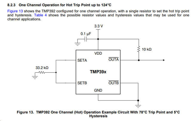

My customer face a similar issue referring e2e post " Start-up "Blip" of TMP392

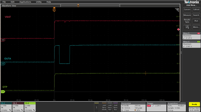

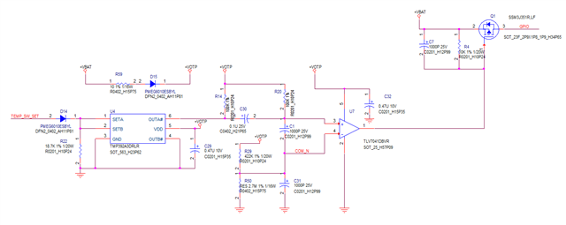

Customer already use 1% accuracy resistor 18.7k to set 70C threshold but has high chance to see the output drop at startup just at room temp.
In DS there is a reset delay time 10ms, does it somehow relates to the reset delay time and meet our expectation?  Any workaround to prevent the drop?   p.s. the drop doesn't drop every time but high chance
Does the low time relate to the Vdd cap? Cause we also see the output low time increased when we add 4.7uF.
The concern is the output connect to a fuse. If there is any abnormal output from our temp switch, it might burn out the fuse.

    Thanks for providing the schematic, scope shot, and looking through the previous post. As Amit mentioned in that linked thread, this blip can occur when the resistors are not sampled correctly on power-up for the TMP392. I see in the schematic that the customer is using a single resistor for SETA and SETB, They should not do this, our team has found that using a single resistor for both SET inputs can cause resistor sampling errors. I suspect that this is the cause of the blip seen in this case. I would recommend to the customer to use a separate 18.7KOhm resistor for each SET input.
