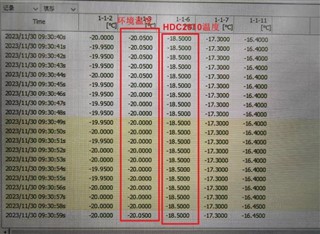

The sensor part of the entire machine casing has been perforated, and the humidity deviation mentioned above is 14%. Therefore, the temperature deviation is more than 1 point
I could use some more detail here. Are you using the HDC2010 to meaure RH close to -20C? When measuing the RH at 90% RH and after the casing is closed, what temp is that being done and what is the HDC2010 reporting? I need to know the degree of RH error. Measuring RH at -20C is not going to be very accurate for any polymer based sensor, which is why we dont make guarantees about RH performance at temperatures that low.

2. When the temperature is at -20 ℃ , the temp that HDC2010 detected with the casing is -18℃ and still exists the error. But the temp without the casing detected is correct. Below is the raw data. The data in front red box is the actual temp and the data in behind box is the tested data.

Zoey,
HDC2010 is not specified to 90% RH, so its RH accuracy is guaranteed at that RH level. However, it is good to see that the device is reading ~2-3% RH error at 25C/90%. Do you have data to show for when the casing is enclosed? Does the ambient RH stay at 90% and the HDC2010 goes up to 100% RH readings? Is there condensation inside the casing after it closes?
So it seems that the HDC2010 is working well in both situations without the casing, and then when the casing is closed RH and Temp can read incorrectly. Is this casing large? Is it completely sealed from the outside environment? Is this board also using TMP112? If so, is there a discrepancy between what the HDC2010 is reading for temp and what the TMP112 reads when the casing is closed?
