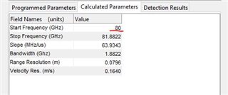

    Thank you for replying to the questions.
    I have used the described matlab code and now able to parse it, but I am not too sure if the LUA script in the described directory is compatible.
    When running the LUA script for   IWRL6432BOOST_DCA1000EVM, I am using common_device_setup_60G.lua and chirp_60G_6m.lua
    Attached image is the resulted configuration, and a calculated parameter through post-process from the mmwave studio. Also the resulted 2D FFT does not seem to be valid.
    On the product page,  IWRL6432BOOST is described as 57-GHz to 64-GHz mmWave, but the above LUA scripts seems to make the configuration to be 80 Gh. Is there LUA script that TI provides for IWRL6432 raw data capture?
    Seho Kim
  • HI, Kim:
    chirp_60G_6m.lua is the LUA example provided by TI.  I think the start frequency display have some problems.  I will look into more detail about those displays and get back to you later.

  • HI, there:
    There is an error at common_device_setup_60G.lua, the following line
    xw_status = mws.selectBDType(c_boardType, 0, 1, 0)
    should change to
    xw_status = mws.selectBDType(c_boardType, 0, 0, 0)
    Let me know if this is helpful.
