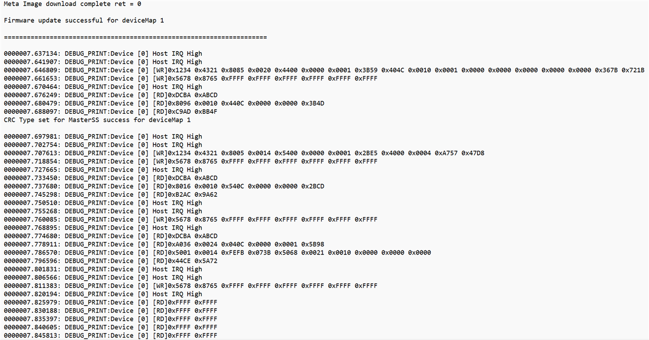

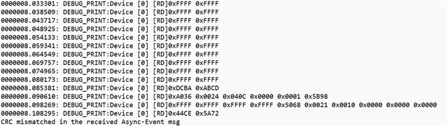

We have a cascaded radar designed based on the TI reference design and facing some issues with the bring up. We are in the process of configuring Master device.
The issue is that after FW download gets completed, and during mmwl_rfenable, the device sends repetitive 0xFFFF to the host processor over SPI. The actual message arrives after lots of 0xFFFF but the application ends up with receiving checksum error which seem to be related to the junk 0xFFFF packets. We checked the MISO on a scope and it's all '1's for a long time.
Any idea what's going on?

  • Saswat,
    We are using dual chip. We tried Master only for now.
    Here is the screenshot from the host processor side.
    Keeps sending 0xFFFF to the host processor, and then some partially valid data, finally the application reports the CRCmismatch/checksum error:

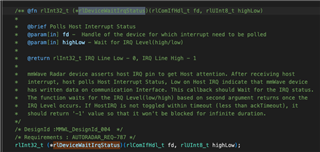

  • Hi Daniel,
    Please make sure that you have implemented below callback function in host application to check if HostIRQ is toggled down.
    * clientCtx.devCtrlCb.rlDeviceWaitIrqStatus = Host_deviceWaitIrqStatus;
    You need to implement Host_deviceWaitIrqStatus function at application which checks the GPIO status (connected to HostIRQ of AWR2243), based on
    rlComIfHdl_t application needs to decide either AWR2243 master or slave device.
    Host application must read the next response or async-event only after AWR2243 bring the HostIRQ down, which can be checked by above callback for mmWaveLink.
    Jitendra

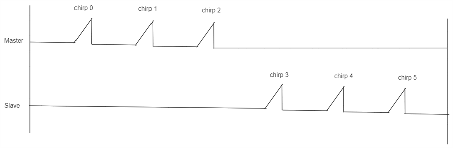

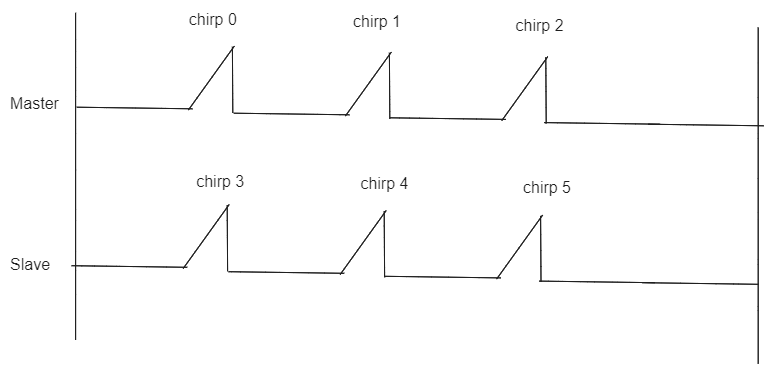

  • Hi Jitendra,
    While we are waiting to get the analysis result on the other AWR chips, can you please confirm if the following configures 6Tx and 8Rx MIMO design in a 2-device radar config?
    Chirp Config api:
    //Master
    chirpCfgArgs->chirpStartIdx = 0;
    chirpCfgArgs->chirpEndIdx = 0;
    chirpCfgArgs->txEnable = 1;
    chirpCfgArgs->chirpStartIdx = 1;
    chirpCfgArgs->chirpEndIdx = 1;
    chirpCfgArgs->txEnable = 2;
    chirpCfgArgs->chirpStartIdx = 2;
    chirpCfgArgs->chirpEndIdx = 2;
    chirpCfgArgs->txEnable = 4;
    Chirp Config api:
    //Slave
    chirpCfgArgs->chirpStartIdx = 3;
    chirpCfgArgs->chirpEndIdx = 3;
    chirpCfgArgs->chirpStartIdx = 4;
    chirpCfgArgs->chirpEndIdx = 4;
    chirpCfgArgs->chirpStartIdx = 5;
    chirpCfgArgs->chirpEndIdx = 5;
    Frame Config api:
    //Master
    frameCfgArgs->chirpStartIdx = 0;
    frameCfgArgs->chirpEndIdx = 2;
     Frame Config api:
    //Slave
    frameCfgArgs->chirpStartIdx = 3;
    frameCfgArgs->chirpEndIdx = 5;
  • Hi Daniel,
    How are you trying to configure these 6 chirps -
          Are you trying to trigger them together? Or
          Are you trying to trigger them one after another(trigger master first, and then trigger slave)?
    Case - I:  This configuration is fine if triggering together.
    Case - II:
    Otherwise in Case-II, create two structures of chirps. One for master MChirps[6] and another for slave SChirps[6]. Configure 6 chirps in each of them where
    For master enable 3 TX for first 3 chirps(chirp0-Tx0, chirp1-Tx1, chirp2-Tx2) and disable TXs for last 3 chirps.
    For slave disable TXs for first 3 chirps and enable TXs for last 3 chirps(chirp3-Tx0, chirp4-Tx1, chirp5-Tx2)
    This way you can trigger the chirps one after another(slave after master) manner. Because MIMO radar uses multiple transmitters and receivers at the same time.
