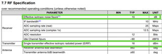

  • I was going by the numbers from the datasheet:
    1843 datasheet:
    1843AOP datasheet:
  • Ok, I understand now. I thought you had measured 10dBm of EIRP on the AWR1843BOOST.
    The AWR1843BOOST uses a PCB patch antenna with ~10dBi of gain. So if we assume 12dBm of power at the ball + 10dBi of gain, this results in ~22dBm EIRP for the AWR1843BOOST. With non-AoP device the overall EIRP of the system will be dependent on the gain of your antenna design, 12dBm is only the power of the TX at the ball.
    The AWR1843AoP utilizes a small single patch antenna on the top of the package. This antenna + the output power of the transmitter results in an EIRP of 16dBm.
    Similarly, the noise figure specified in the AWR1843 datasheet is at the device RX pin and the total system noise figure will be dependent on the antenna design. However, the noise figure specified in the AWR1843AoP is very similar to transmitter's effective isotropic radiated power (EIRP) where Tx output power + Antenna gain - Losses are considered. In the similar way for the receiver's Receiver Noise figure + antenna gain -losses are considered for the effective isotropic noise figure. These numbers could be directly used in the link budget calculations.
