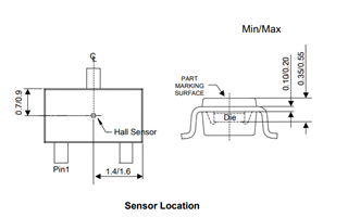

May I know where hall sensor location and die size? also need bottom distance.

The DRV5013 sensing element is similar to the DRV5023. The Hall element is located in the center of the package in the xy plane with a tolerance of ±100 um. The Hall element is 0.7 mm from the bottom of the package with a tolerance of ±50 um.
As for die size, I cannot share that information.
