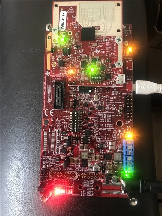

We recently received a replacement for the MMWAVEICBOOST and after the first use I was not able to either flash it or Collect data.
Ti team has mentioned that he could be the EVM but I do not know much about that. I’m using the same 5v power supply that we always used.
this is the 3rd one already, And I’m starting to get frustrated and irritated about using this device. It’s slowing down my experiments, as well as the writing of my research paper process and also my team work as well.

    3. Is DS3 (NERR LED) on the MMWAVEICBOOST illuminated? It is hard to tell from your picture.

  •  Hello
    1. Yes tried both modes an nothing works, neither being recognized
    2.
    3.only one light is on the one at the extreme left . Everything else is is barely on or not at all as you can see.

    When you say this do you mean that the serial ports do not show up on your computer after connecting the MMWAVEICBOOST via USB? Or the ports do show up but flashing fails? The ports should be seen in device manager as in the image below.
    Additionally, there are 2 micro-USB ports on the MMWAVEICBOOST board. Please ensure that the USB connection to the PC is using the port labeled "XDS110 USB".
    Also I just want to make sure that when you are testing this, you are using the correct switch settings for S1 on the ICBOOST to support ICBOOST+EVM operation. Based on your picture the settings look incorrect. The correct settings are listed on this page under the section mmWaveICBoost Initial Configuration. Are these the settings you have tested with?
    Josh
  • The device does not appear at all which means no ports are being found.
    And yes I did use the proper configuration prior to taking this picture. I would like to mention that This is not the first device we have worked with, but it’s the 3rd one, and we still have a functioning IWR1443.

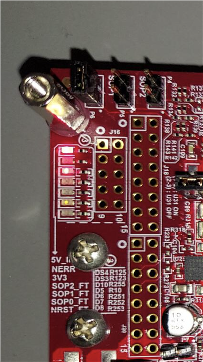

  • Here is a picture of the previous replacement
    And this is a close picture of the current replacement
    D11 - low green
    D14 - none
    DS1 - red
    D10 - none
    DS3 - low red
    DS4 - low yellow
    correct me if I’m wrong

  • Hi Mickael,
    The D11 Green suggests the input is more than 5V, I suppose that being the root root cause for MMWACEICBOOST to go bad.
    See table 2-15 of 60GHz mmWave Sensor EVMs (Rev. E) (ti.com)
    To use a supply more than 5V please make these below changes.
    Ankit
  • Hello, you got the wrong one ! This picture you using is from the 2nd replacement from months ago.
    The current one is the main picture on top of thread. ( see the one with the sticky note)
  • Hi Mickael,
    The D11 LED glowing low green on current EVM also suggests that the power supply is greater than 5V. Please clarify if the same adaptor was used to supply the input voltage to both the boards.
    Ankit
    yes it is. And you can see the attached picture above as reference, which proves that it does produce the regular voltage needed and does not exceed it.
