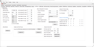

  • Thanks for your response, but I cann't find rlSetContModeConfig and rlEnableContMode APIs on mmwave studio, there are so many buttons, can you upload a picture?

    In mmwave studio you can go to ContStream tab for continuous streaming configuration.
    Here is a screenshot for the same -
    In the StreamConfig area set the values of the parameters and click set(1). Then set the StreamEnable Enable(2). Now you will be able to transmit a continuous wave.

    Thank you very much.I followed your answer, when I click capture(4) and then discature, DCA1000evm continuously cllects data( the light keeps flashing), I cann't stop it. What's the reason?  Is there any error?
    And I want to konw what button set(3) means? Is this preprocessing of received data?

    This set(3) button is applicable for Basic Configuration for Analysis blockIt helps you configure the parameters for analysis tool.
    [P.S: Whenever you click a button, it calls a specific function and you can check that in the output window. Now in the Lua shell, type "help ar1.<function_name>". That will display the function details. You can check details of any function here.]
