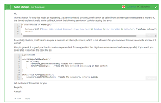

I'm trying to send data using J1 CAN-FD Connector of AWR1843BOOST EVM in CCS-Debug Mode. The device I'm using is AWR1843AOP.
Everything works fine till the wire to the receiver is not connected. But as soon as I connect the EVM J1 CAN-FD connector to the external controller to read the data I get run time error and program terminates execution.
Any insight into this issue would be highly appreciated.
Here is the screenshot of the debug screen from CCS IDS.
