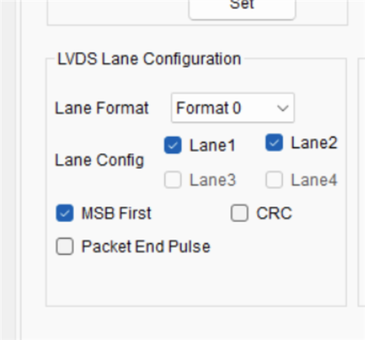

Lane3 and Lane4 in the figure cannot be selected. How can I select them

IWR6843 only uses 2 LVDS lanes. Please refer to section 6 of the mmWave Radar Devices ADC Raw Data Capture Guide.
