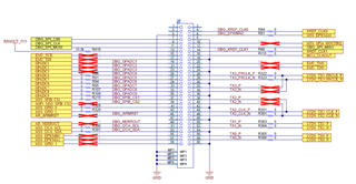

The input voltage of AWR2944EVM is 12V, but is it able to supply 5V to DCA1000EVM via SAMTEC connector and having DCA1000EVM's switch in RADAR_5V_IN mode ?

No, this is not possible. If you look at J3 of the DCA1000EVM schematic you will see VCC5V_CONN, however then if you have a look at J7 of the AWR2944, you will see pins 1,2, and 3 are not connected.
J3 on DCA1000EVM:
J7 on AWR2944EVM:
DCA1000 design files (includes schematic): https://www.ti.com/lit/zip/sprr350
AWR2944EVM schematic: https://www.ti.com/lit/zip/sprr440
