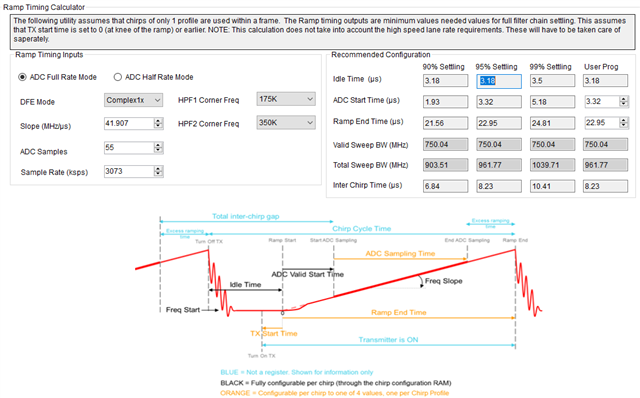

    Currently, I am checking the waveform by acquiring ADC RAW data with the ramp timing shown below.
    adcStartTime is set to 3.64us against the 95% settling value 3.32us.
    However, looking at the obtained IF waveform, it seems to be quite unstable immediately after sampling starts.
    Other parameters are:
    rameEndTime = 23.3us
    idleTime = 6.01us
    txStartTIme = 0us
    This instability can be resolved by increasing rampEndTime and delaying adcStartTime, but in order to satisfy the required measurement performance, it is not possible to increase rampEndTime.
    Is there any workaround?
    Hiroyuki

  • Hi Hiroyuki,
    Here are some methods that you can try based on inputs from the team to adjust the settling time of the filter:
    1. Increase HPF cutoff freq
    2. Reduce RF gain or TX power
    3.  Check if on board TX RX isolation can be improved
    4. Increase sampling rate
    Kaushik

  • Hi Kaushik,
    I tried methods 1 and 2, but no improvement was seen.
    On the other hand, increasing the sample rate seems to be effective.
    Unfortunately, it is not possible to increase the sample rate in this application, but why would increasing the sample rate improve the performance?
    Hiroyuki
  • Hi Hiroyuki,
    Digital filter settling depends on the rate at which filter runs, which depends on sampling rate. Adjusting the sampling rate would change the filter's settling time directly.
    Kaushik
