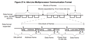

Hi, ti team,
   I'm having a little problem and hope to get your help. Now, i got AWR6843 to work in IDLE-LINE mode. The first frame sent by the sender side is a data frame, but the receiver side is judged to be an address frame. In the IDLE-LINE mode, if the interval between frames exceeds 10 bits, the address frame is determined. Since the receiving data line of UART is always high, from the end of UART initialization to beging of the first data frame which exceeds 10 bit, so the frame is judged to be the address frame by the receiver side. Am I understanding correctly? If yes, how can I fix it?
Anymore, what is the recommended workflow in IDLE-LINE mode after the power-up initialization is over?
