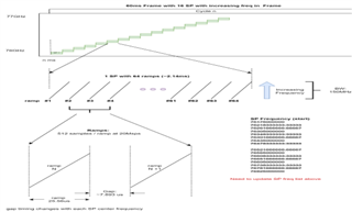

For example, I want to configure the waveform to each frame contains 16 subframes and each subframe contains 64 chirps, which parameters should I configured in rfcontrol.c?

The below application note will be a good starting point.
Programming Chirp Parameters in TI Radar Devices (Rev. A)
Please refer to the DFP user guide for to understand various features of the device and get started on the waveform designing. You can also refer to the example code provided for AWR294x devices on how to use the RF APIs.
DFP Docs: ti\mmwave_mcuplus_sdk_04_04_01_02\mmwave_dfp_02_04_09_01\docs
Example code: C:\ti\mmwave_mcuplus_sdk_04_04_01_02\mmwave_dfp_02_04_09_01\ti\control\mmwavelink\test
