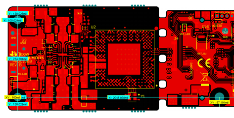

I'm studying AWR1843AOPEVM and I would like to make holding jig for measurement.
1) AWR1843AOPEVM has four holes for screw. Please let me know the dimension from Board edge to these holes center. (X,Y direction)

2) Please let me know the dimension from Board edge to MMIC(AWR1843AOP) edge. (X,Y direction)
(I would like to calculate the rotation center. )

Hello Shoko,
Adding to Whart Josh has mentioned.
1. The placement of the holes from the borders can be seen here:
2. Below is the distance of the MMIC from the edge.
