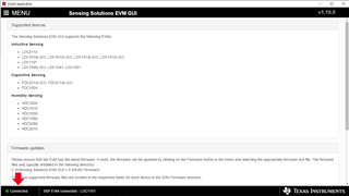

I installed "SensingSolutionsGUI-1.10.0-windows-installer.exe" on a Windows 10 Pro 64 bit version 22H2 computer. The "Sensing Solutions EVM GUI" version 1.10.0 works, but with limited functionality:
The drivers are installed:
The program connects to the LDC1101EVM:
Registers can be read:
Moving the coil near the coil changes the RP_DATA_LSB and RP_DATA_MSB, so things seem to be working.
The problem is the Device, EVM, and Configuration menus are blank. The buttons to write to the registers or data stream don't work either. Other than reading registers, nothing seems to work.
I tried the following:
  • Rebooting
  • Installing the software using the administrator account
  • Running using the administrator account
  • Updating the firmware
  • Running in Windows 7 comparability mode
  • Attempted to run the NI-VISA runtime from "2541.Fix_LDC1101_GUI_com_port_issue.zip" but it crashed
  • Updated the NI-VISA runtime to 23.8
