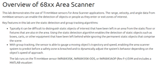

1. To examine the existing static points, it is necessary to modify the 'clutterRemoval' parameter in the cfg to observe static points while running the area scanner demo. However, the C code indicates that all static clutter is being removed, as depicted in the accompanying image.
(Source of the figure below: https://dev.ti.com/tirex/explore/node?node=A__AFyYCAdcHqcZz7WN9UQc.g__com.ti.mmwave_industrial_toolbox__VLyFKFf__LATEST )
Which file should I modify if I intend to generate a track using all static points through C code?

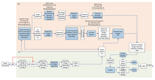

3. According to the area scanner user guide, the static points corresponding to the background are eliminated for a few frames following the initial radar execution, as illustrated in the figure below. Subsequently, the static points measured thereafter are managed independently. I am curious about the specific C file where I can locate these post-background removal static points.\
(Source of the figure below: https://dev.ti.com/tirex/explore/node?node=A__AONFBQevesFfseDnZda2rw__com.ti.mmwave_industrial_toolbox__VLyFKFf__LATEST )
