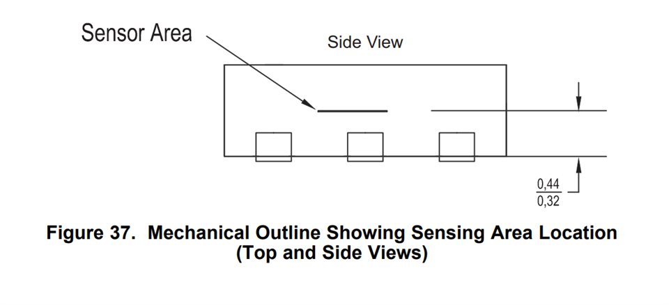

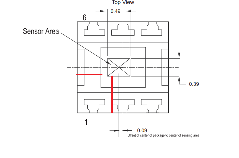

My customer GWM-NOBO is using OPT3001-Q1 as light sensing. They need the sensing area's position in the IC to decide the mechanical parameter of opening.
Could you please share it?

Hi Daniel,
They should just need the sensor area height 'hs' which is provided below.
