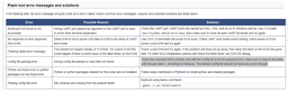

  • Mike -
    From flash tool error messages and solutions:
    Check the message that is printed, and edit the config file to fix the parsing errors. Make sure to specify file paths with forward slash /, including in Windows. The default config file should not have any errors though.
    I see this line in your post: cmd.exe /C "cd /D C:\Gen40_TI\gen40_dev\sw\boot\scri...t/scripts/uart_uniflash.py -p COM6 --cfg=uni_ppar_awr.cfg"
