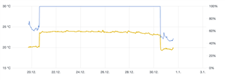

Can you guide us to the route cause of the problem on the attached file? Now the values for temperature and RH aren't 0. The RH is 99.6% and the temperature suddenly jumps with around 3 Celsius degrees. Any help is highly appreciated!
That problem looks like that one: https://e2e.ti.com/support/sensors-group/sensors/f/sensors-forum/1017648/hdc2010-erroneous-temperature-data-and-hh_status-1/3761854?tisearch=e2e-sitesearch&keymatch=hdc2010%25200xfe#3761854
I use 8 bit data representation for the humidity, so 99.6% RH in raw is 0xFFFE.
Our device is battery powered, so increasing the current consumption is not an option.
I hope now good solution will be possible.

Martin,
So does the customer see similar register dump values when the reads are bad, like a value of 0xF6 in register 0x0F? If so, then these HDC2010s have this bug in the linked post. I have attached a slide deck with more details on this.
HDC2010_HDC2080_Register_Corruption_Issue_Public (002).pptx
If this is in fact the problem, and increased current consumption is not allowed, the customer will need to either operate below 2.3V VDD, or purchase new HDC2010s from TI since we have replaced all the stock with the bug.

Unfortunately we can't read the registers in this moment on the client devices.
Before we was facing bad temperature values and HDC2010 software reset seems to fix that problem.
Do you think just software reset will fix and that problem?
I can make HDC2010 to be reseted when the read RH is above, let's say, 80%. What do you think?
Martin,
If that has worked for you in the past, then I would suggest you implement that. Especially if you cant implement the higher current demanding software fix I sent you. On previous E2E threads about this I have also seen 2 software resets can help, so you can try that as well.
I do suggest that you try the software fix I linked on at least 1 HDC2010 setup, just to see if that will resolve the issue. What supply voltage are you operating at?

Martin,
Yes the temperature can also have bad reads, usually reading 0x00 (-40C) or a value close to that. Have you had any luck with just trying software resets.

Martin,
It just lends more credit to the floating node bug being the issue. If the customer has a mix of older and newer HDC2010s, that's how this can show up on only some devices. If there was a problem with the communication or PCB on the customer's end, they shouldn't see only some of the parts having this issue.
