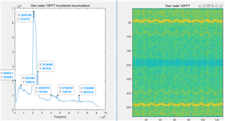

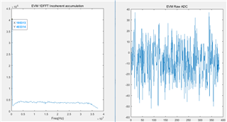

For AWR2944 of our own radar board, we found many spurs in FFT spectrum of ADC data. The wave config is single tone waveform. The EVM does not has the spurs.
Below are the ADC data and FFT spectrum of ADC data, of our own radar and EVM.
The spurs of our radar board are at 2MHZ, 4MHZ, 7MHZ;

    What is the switching frequency of your PMIC and pre-regulator? Most likely there is some switching noise coupling through the power supplies.
    To debug, I would recommend to first feed the 1.0V and 1.8V through an external power supply and see if the spurs resolve. If so this will confirm it is a power supply issue which will help give some direction to debug.
