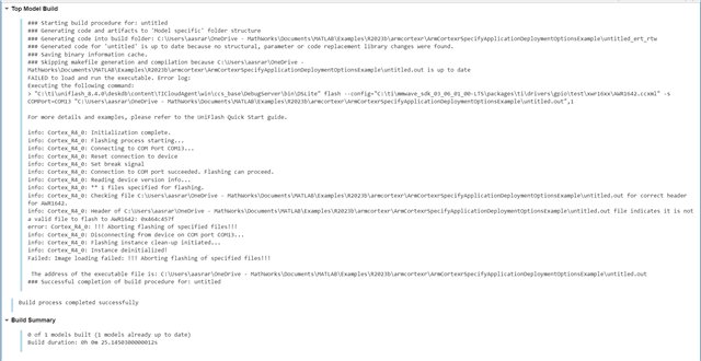

I am encountering an issue while attempting to program the AWR1642Boost with an executable using the dslite command. The process is consistently failing with an error message indicating that the provided file is not valid for flashing.
Additionally, I have attempted to convert the `.out` file to a `.bin` format and repeat the flashing process, yet the error persists.
    The executable is not flashable.
    A flashable image must be created using the ImageCreator tool
    Please see
    C:\ti\mmwave_sdk_03_06_00_00-LTS\packages\scripts\ImageCreator\Image_Creator_User_Guide.pdf
    Thank you
