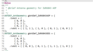

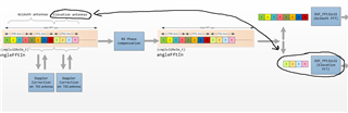

If I understood correctly, you are mentioning about peak grouping on 2D angle FFT as mentioned in aoa2dproc index.html file documentation. But I couldn't understand how integrating 2D angle spectrum over azimuth will give elevation and vice-versa. Could you please explain this more for me to understand this?
For IWR6843ISK-ODS, across which channels shall I perform fft on angle FFT to get the required azimuth and elevation angles? Requesting you to please explain this in detail on finding angles for ODS antenna. arrangement
I am using the below function to get the azimuth and elevation angles. The input to function is 2D angle spectrum. Will it possible to look into it?

This function is for IWR1843BOOST keeping in mind its virtual antenna arrangement and chirp order Tx0, Tx1 and Tx2.
