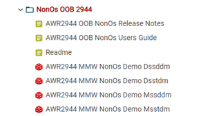

I import NonOS Demo Msstdm in toolbox  to CCS,when I Rebuild Project first time , it's OK
