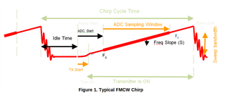

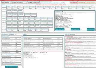

Following my previous question here: https://e2e.ti.com/support/sensors-group/sensors/f/sensors-forum/1306352/dca1000evm-awr1843-not-receiving-raw-datas-as-expected, I would now what are the exact frequencies acquired by the ADC. Regarding mmwaveSensingEstimator, with the following configuration, and the above diagram given in (https://www.ti.com/lit/an/swra553a/swra553a.pdf?ts=1628143440604), my understanding is that the F0 (First frequency acquired by ADC) = Ft (last frequency acquired by ADC) - Valid_Bandwith(which is equal to FreqSlope*Num samples/SamplingRate), am I right ? If yes, for a chirp of 256 samples, does the 256 frequencies correspond to F0 + n*FreqSlope/SamplingRate ?
Or does F0 = freqSlope * adcStartTime + startFreq(77e9) ? Then what would be the vector of frequencies ?

    Thanks for posting your question on sampling and ADC data. Your initial equations for determining the start frequency - assuming you know the last sampled frequency - and the frequency associated with each sample are correct. The other equation you proposed for the start frequency using the ADC start time would also be valid but might not be as accurate due to the synthesizer ramp up settling time which means the chirp slope prior to the ADC start time is not constant/stable, so the frequency spanned during that time might differ from the ideal/calculated value. The synthesizer ramp-up settling time and other factors are mentioned in Section 5.2 of the Programming Chirp Parameters app note you referenced.
