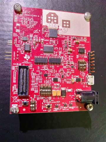

  • Hi, Josh,
    I did change the switches and I was using the default configuration. I did try all four options, none of them worked.
    Thanks for the response and sharing a picture of your board. You switch settings are indeed correct for functional mode.

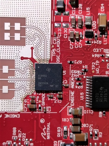

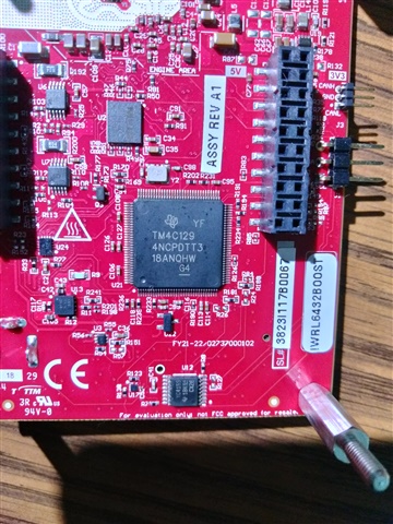

  • Hope this is the package you want to see.
    That is not the correct device. I apologize I should have been more specific. It should be the smaller chip on the front of the EVM where the antenna traces are leading to.
    Josh
    Thank you. It seems your device is ES1.0 so you are using the correct FW for your device. One more point of clarification, have any hardware modifications been made to the EVM?

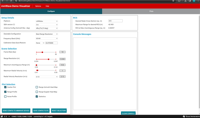

    This is from Radar Toolbox, I am not getting the response either.
    It is possible that my board is not working?

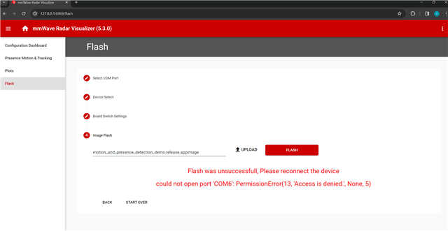

  • I am trying to reflash. This time, I am getting access denied error.
    1. The image you shared in the post above is actually not the visualizer I was referring to. That visualizer does not support the IWRL6432 so the response you are seeing is expected. Please refer to the Presence and Motion Detection User's Guide. This guide gives steps for running the demo with either the SDK Visualizer (which you have tried and are seeing issues with) as well as the Industrial Visualizer (this is a python based application located at <RADAR_TOOLBOX_INSTALL>/tools/visualizers/Industrial_Visualizer). You can also double check to make sure that every step in this guide is followed to ensure you are not missing any required procedure.
    2. The access denied error that you are seeing when trying to reflash the appimage is usually observed when some other program running on the PC is still holding the com ports open (for example: teraterm, or some other visualizer application). Please ensure these programs are shut down/disconnected before attempting to reflash the board.

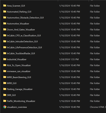

  • Thanks.
    Which configuration file should I choose?
    <RADAR_TOOLBOX_INSTALL_DIR>\src\ti\examples\<ExampleName>\chirp_configs
    There are many Examples in the folder.
    Inside /Industrial_Visualizer, there is no chirp_configs file.
    The user guide states that one of the configurations at <RADAR_TOOLBOX_INSTALL_DIR>\source\ti\examples\Presence_and_Motion_Detection\chirp_configs\ can be used. Alternatively, the configurations at C:\ti\MMWAVE_L_SDK_05_03_00_02\examples\mmw_demo\motion_and_presence_detection\profiles\xwrL64xx-evm can be used.
    Josh
    Which config file should I use? There are 6 config files.
    I tried motionDetect.fcg and PresenceDetect.cfg. Both did not show anything.

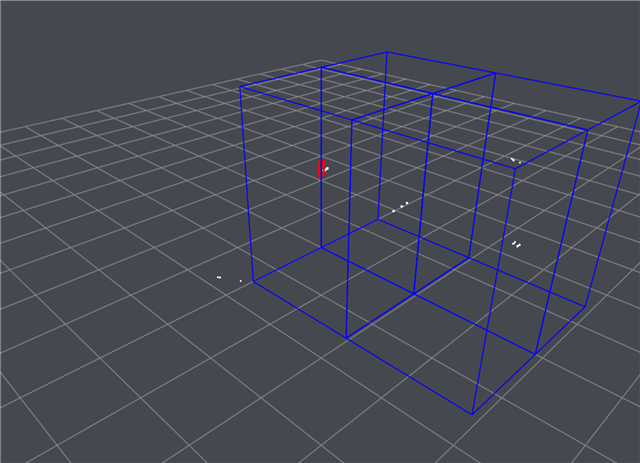

  • Update
    This time, I think I have missed the switch.
    I see white dots on the screen
  • The white dots are detected points in the point cloud which are being plotted in a 3D space. This means that at least your board is working as you have sent the configuration and received output data. Have you retried again with the SDK visualizer now that you managed to reflash the demo appimage? If so, do you still see the frame counter stuck a 0 and plots not updating?
    Josh
  • Now the high performance motion detect works. The low power presence detect is not working.

    * Serving Flask app 'visualizer' (lazy loading)
    * Environment: production
    WARNING: This is a development server. Do not use it in a production deployment.
    Use a production WSGI server instead.
    * Debug mode: off
    WARNING: This is a development server. Do not use it in a production deployment. Use a production WSGI server instead.
    * Running on http://127.0.0.1:6969
    Press CTRL+C to quit
    Starting UI ...
    127.0.0.1 - - [25/Jan/2024 20:51:03] "GET / HTTP/1.1" 200 -
    127.0.0.1 - - [25/Jan/2024 20:51:03] "GET /runtime.js HTTP/1.1" 200 -
    127.0.0.1 - - [25/Jan/2024 20:51:03] "GET /polyfills.js HTTP/1.1" 200 -
    127.0.0.1 - - [25/Jan/2024 20:51:03] "GET /styles.js HTTP/1.1" 200 -
    127.0.0.1 - - [25/Jan/2024 20:51:03] "GET /scripts.js HTTP/1.1" 200 -
    127.0.0.1 - - [25/Jan/2024 20:51:03] "GET /vendor.js HTTP/1.1" 200 -
    127.0.0.1 - - [25/Jan/2024 20:51:03] "GET /main.js HTTP/1.1" 200 -
    127.0.0.1 - - [25/Jan/2024 20:51:03] "GET /roboto-latin-400.woff2 HTTP/1.1" 200 -
    server listening on 127.0.0.1:6974
    WebSocket Server Started
    127.0.0.1 - - [25/Jan/2024 20:51:03] "GET /assets/images/Flowchart.png HTTP/1.1" 200 -
    127.0.0.1 - - [25/Jan/2024 20:51:03] "GET /MaterialIcons-Regular.woff2 HTTP/1.1" 200 -
    127.0.0.1 - - [25/Jan/2024 20:51:03] "GET /roboto-latin-500.woff2 HTTP/1.1" 200 -
    127.0.0.1 - - [25/Jan/2024 20:51:03] "GET /roboto-latin-700.woff2 HTTP/1.1" 200 -
    127.0.0.1 - - [25/Jan/2024 20:51:03] "GET /visualizer/api/version HTTP/1.1" 200 -
    connection open
    127.0.0.1 - - [25/Jan/2024 20:51:09] "GET /visualizer/api/configuration HTTP/1.1" 200 -
    127.0.0.1 - - [25/Jan/2024 20:51:09] "GET /visualizer/api/serial/comports HTTP/1.1" 200 -
    127.0.0.1 - - [25/Jan/2024 20:51:09] "POST /visualizer/api/configuration HTTP/1.1" 200 -
    127.0.0.1 - - [25/Jan/2024 20:51:09] "GET /assets/images/mdi.svg HTTP/1.1" 200 -
    127.0.0.1 - - [25/Jan/2024 20:51:09] "GET /assets/images/functionalMode.png HTTP/1.1" 200 -
    127.0.0.1 - - [25/Jan/2024 20:51:15] "POST /visualizer/api/configuration HTTP/1.1" 200 -
    Join
    Device reset successful and ready for reconfig!!
    127.0.0.1 - - [25/Jan/2024 20:51:18] "GET /visualizer/api/reset HTTP/1.1" 200 -
    None
    a
    C
    Successfully connected to COM6 ...
    True
    Start parsing messages ...
    Visualizer Core Started
    Requesting for versions
    Command to device : version
    Command to device : sensorStop 0
    Command to device : channelCfg 7 3 0
    Command to device : chirpComnCfg 18 0 0 128 4 30 0
    Command to device : chirpTimingCfg 6 28 0 90 59.75
    Command to device : frameCfg 8 0 400 1 250 0
    Command to device : guiMonitor 2 2 0 0 0 1 1 0 0 0 0
    Command to device : sigProcChainCfg 64 8 2 0 4 4 0 .5
    Command to device : cfarCfg 2 4 3 2 0 12.0 0 0.5 0 1 1 1
    Command to device : aoaFovCfg -60 60 -40 40
    Command to device : rangeSelCfg 0.1 4.0
    Command to device : clutterRemoval 1
    Command to device : compRangeBiasAndRxChanPhase 0.0 1.00000 0.00000 -1.00000 0.00000 1.00000 0.00000 -1.00000 0.00000 1.00000 0.00000 -1.00000 0.00000
    Command to device : adcDataSource 0 adc_data_0001_CtestAdc6Ant.bin
    Command to device : adcLogging 0
    Command to device : lowPowerCfg 1
    Command to device : factoryCalibCfg 1 0 40 0 0x1ff000
    Command to device : mpdBoundaryBox 1 0 1.48 0 1.95 0 3
    Command to device : mpdBoundaryBox 2 0 1.48 1.95 3.9 0 3
    Command to device : mpdBoundaryBox 3 -1.48 0 0 1.95 0 3
    Command to device : mpdBoundaryBox 4 -1.48 0 1.95 3.9 0 3
    Command to device : sensorPosition 0 0 1.44 0 0
    Command to device : minorStateCfg 5 4 40 8 4 30 8 8
    Command to device : clusterCfg 1 0.5 2
    Command to device : baudRate 1250000
    Command to device : sensorStart 0 0 0 0
    127.0.0.1 - - [25/Jan/2024 20:51:26] "POST /visualizer/api/vs-core/setup-device HTTP/1.1" 200 -
    127.0.0.1 - - [25/Jan/2024 20:51:26] "GET /visualizer/api/configuration HTTP/1.1" 200 -
    127.0.0.1 - - [25/Jan/2024 20:51:27] "POST /visualizer/api/configuration HTTP/1.1" 200 -
    This is strange behavior. If one of the default configuration files is working for you then there should be no HW issue so the other default configurations should also be working. Please allow me to attempt to replicate this behavior on my end and get back to you. Thank you for your patience.
    Josh
  • Hi Victor,
    I'm very sorry for the delay here. I have not been able to replicate the issues you are seeing with the default configurations. Are you still having this issue? If so, we may need to look at another way to debug the problem.
    Josh
