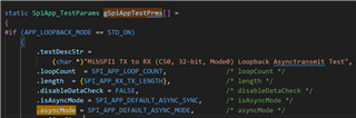

  • Yes, I used the same example code provided in MibspiApp.c, and also the same behavior because I did not configure TxRxIrq in my side.
    let me explain the issues to you on the code level;
    First issue:
    I started by calling Spi_SyncTransmit(), then the code did some process preparation related to the job's state, and sequance statues until it went to The "Spi_DlcConsumeEvent" function which is responsible for filling the data into the SPI TxBuffer and then triggers the transmission,
    the problem as you can see in the image below is that this function triggers only the first spi word (16 bits) and doesn't wait until the transmission is done (this what I'm expecting from synchronous function).
    So in my case the channel size consists of multiple spi words (32 bit), only the first 16 bits will be sent because the code is waiting IRQ to trigger the next spi word.
    "Spi_IrqTxRx" Function
    the second issue:
    The coping of SPIBUF register to application RX buffer is done only in TxRxIrq , So it will only work if we are using Asynchronous SPI request.
    Please if you are still having trouble understanding the issue, feel free to set up a meeting to explain the issue to you in more detail

  • Hi Mohamed,
    Can you check the following things in the MibspiApp.h file
    In the  SpiApp_TestParams gSpiAppTestPrms[] struct , what value you are using for .isAsynchMode did you change the default ASYNC/SYNC transmit flag for synchronous mode?
    if not done yet, can you try changing it for synchronous mode and test your code.
    Shruti
  • The variable you mentioned "isAsynchMode" is used to choose the Asynch mechanism whatever it is pooling or interrupt
    In my case, I don't use the Asynch function in the first place, so this won't affect me at all.
    Could you try the Synchronous function in your side , and if possible add me to the debugging session please to speed up the process?
  • Hi Mohamed ,
    So there are 2 different things in the test params struct  -
    1. isAsyncMode - which defines whether to use async transmit or sync transmit.
    2. asyncMode - Whether to use polled or interrupt mode in async transmit.
    what you have mentioned above is asyncmode  , not isAsyncMode  , the possible values of isAsyncMode is either 0 or 1 , 0 stands for sync transmit mode , as of now in the MibspiApp.h file it's value has been set as 1 , can you verify if you have changed it to zero?
    Shruti
  • Hi shruti,
    Sorry for the typo, I meant "asyncMode" but I'm using the Spi_SyncTransmit function directly, as I mentioned to you a day ago.
