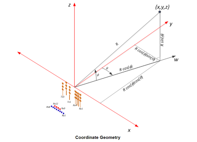

Hello Team,
I use AWR1843Boost for my project, I want to know about which coordinate system is used in AWR1843boost (Left hand system or Right hand system)..?.

Hi Miit,
The orientation of x,y and z axes relative to the sensor is as per the following figure.
