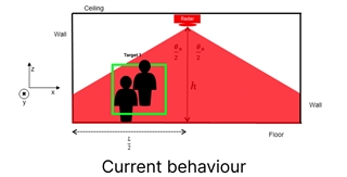

Hello everyone, I'm facing a problem with my overhead people counting algorithm, it is placed above a hallway in front of an entrance door, the use case is a bi-directional counter for understanding the number of entries and exits.
The algorithm is very lightweight as it considers and processes just the X coordinate of the target it's seeing, this is due to the nature of the use case; the hallway is along the X direction therefore just one coordinate is needed.

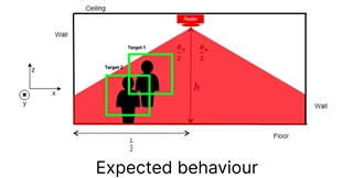

The problem is that it struggles in separating people when passing close together, it considers those as a single target (fig1 "current behaviour") while being multiple target (fig2 "Expected behaviour").
In my case the following parameters are valid: h=2.7m L=6m Θ=64°  for such height i discovered i can reach a max detect distance of ~2.15m (using the formula found here) which is actually enough as my major problem is the detection sensitivity inside this area.
The hallway is about 6m long and large 2m, the sensor is installed on the ceiling (height about 2.7m), you can see the following fig3 for a brief summary map of the installation top view.

    How far apart are the people when they are tracked as one? Typically, a minimum of at least 0.5m separation is required. Due to the fundamental limitations of the antenna you will likely have trouble resolving people that are not at least 0.5m apart.

    Indeed, my problem is that people often pass by the sensor closer than 0.5m to each other. Are there any method to increase the sensitivity of the sensor to less than 0.5m maybe changing some parameters from the algorithm or from the PCL computing section inside the sensor firmware.

    Is it possible for you to switch to a wall mount configuration and using an antenna pattern like that of the IWR6843ISK EVM? This may help slightly as the better angular resolution in the azimuth direction should give the gTrack algorithm more information to work with. Though I believe this will not entirely resolve the issue if 2 people are very close to each other but you should see some improvement.
    One might also explore using a ML approach to solve this problem. There is an area of ML that looks at these types of problems called Gaussian mixture modelling. This might be something you could explore if you have the resources.
    There is also this paper which explores alternative approaches to solving this problem. However, currently our SW offering only contains the group tracker method for people counting/tracking.
