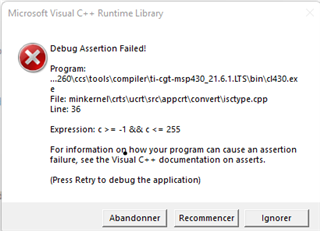

I am trying to use the OPT3101 SDK to perform full calibration on a few OPTs.
As advised, I am using compiler version 18.12.8 LTS.
But I get these errors:
Building file: "../MSP430/USB_config/UsbIsr.c"
Invoking: MSP430 Compiler
"C:/ti/ccs1260/ccs/tools/compiler/ti-cgt-msp430_18.12.8.LTS/bin/cl430" -vmspx --data_model=restricted --use_hw_mpy=F5 --include_path="C:/ti/ccs1260/ccs/ccs_base/msp430/include" --include_path="C:/Users/mbarthel/Documents/Étude/Télémètre V3/sbac203b/sbac203b/release_0p9p1/OPT3101_SDK" --include_path="C:/ti/ccs1260/ccs/tools/compiler/ti-cgt-msp430_18.12.8.LTS/include" --advice:power="all" --define=__MSP430F5529__ -g --printf_support=full --diag_warning=225 --diag_wrap=off --display_error_number --silicon_errata=CPU21 --silicon_errata=CPU22 --silicon_errata=CPU23 --silicon_errata=CPU40 --preproc_with_compile --preproc_dependency="MSP430/USB_config/UsbIsr.d_raw" --obj_directory="MSP430/USB_config"  "../MSP430/USB_config/UsbIsr.c"
MSP430/USB_config/subdir_rules.mk:9: recipe for target 'MSP430/USB_config/UsbIsr.obj' failed
INTERNAL ERROR: C:/ti/ccs1260/ccs/tools/compiler/ti-cgt-msp430_18.12.8.LTS/bin/cl430 had an internal inconsistency and aborted
                  while processing file ../MSP430/USB_config/UsbIsr.c
This is caused by a defect in the TI C/C++ Compiler.
TI Customer Support may be able to suggest a workaround to avoid this.
Upgrading to the newest version of the compiler may fix this problem.
Contact TI in the E2E support forums at http://e2e.ti.com under
"Development Tools", "TI C/C++ Compiler".  See the link titled
"Submitting an issue".
We need to see this ENTIRE error message and a complete, reproducible
test case including ALL of the command-line options.
gmake: *** [MSP430/USB_config/UsbIsr.obj] Error 2

Moreover, I have this pop-up:
(in this pop-up it written another compiler version because I tried two compiler versions)
Of course, clicking on retry does not solve the problem.

  • I'm confident this is similar to the problem resolved in this forum thread.
    Thanks and regards,
    -George
  • I had some accent in my workspace path... I removed them and it worked. Thanks!
