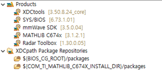

I'm currently doing various experiments with the iwr6843isk board.
The ongoing experiment is testing a wider range of detection by increasing the gain by changing the antenna.
The current development environment is as shown in the picture below.
I am sending you the dss build log for your reference.

I looked at the code to modify the ANTDEF_AntGeometry setting, but first, the ANTDEF_AntGeometry value was not defined in radar_toolbox.
So my question is
How to change Antenna geometry settings in Radar_toolbox
or how to use antenna_geometry.c in SDK (C:\ti\mmwave_sdk_03_05_00_04\packages\ti\board) to build
Thank you always.
    Please see how this is done in the out-of-box demo for IWR6843ISK-ODS, at {RADAR_TOOLBOX/source/ti/examples/Out_Of_Box_Demo/src/xwr6843ODS}. You can create a copy of the antenna_geometry.c file and customize as needed, then you can modify the .projectspec file to import your customized antenna_geometry.c file. Then delete the project in CCS and reimport.
    Josh
